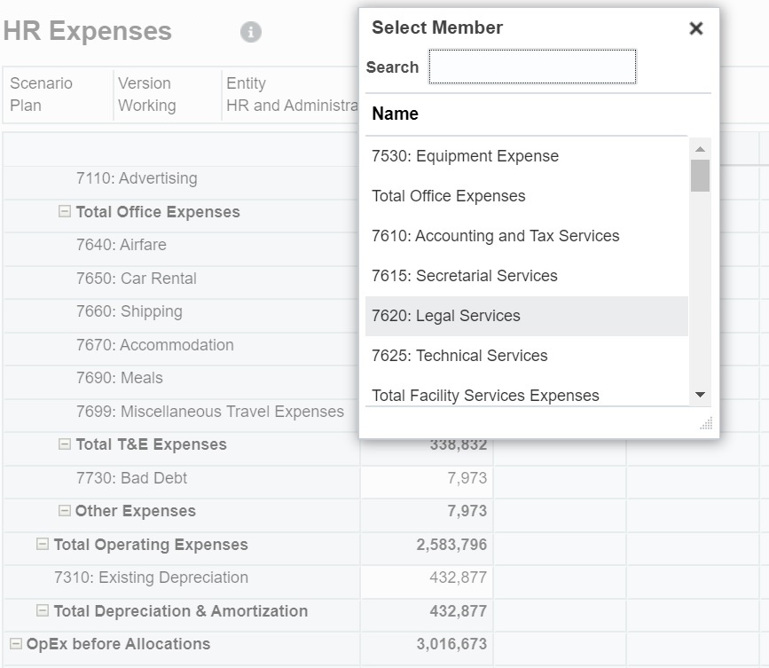

Click the down arrow in the cell to launch the member selector, then scroll or search for the member to add.
Here's an example of the member selector after clicking the down arrow in the
7645: Airfare
cell. You can enter a member name in the Search box or scroll through the list to locate the member to add. For this example, we'll choose7620: Legal Services

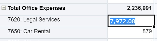

.Click in editable cells to add or change data. For example, the
data cell shown here can be edited: -
In the row you have just added, modify or add data in the editable cells, as you require, and then click Save.

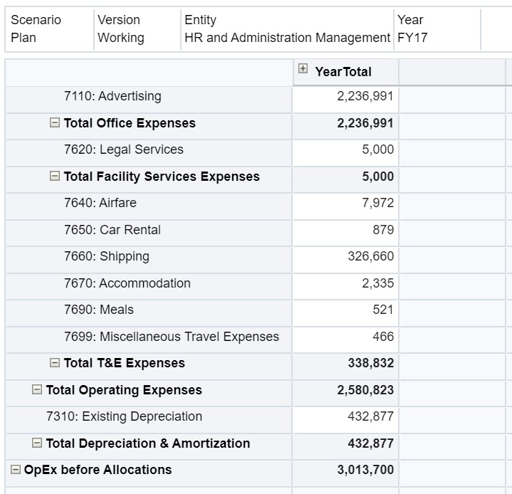

In this example, the
7620: Legal Servics
member and the data that was entered (5,000) is added to the form. -
