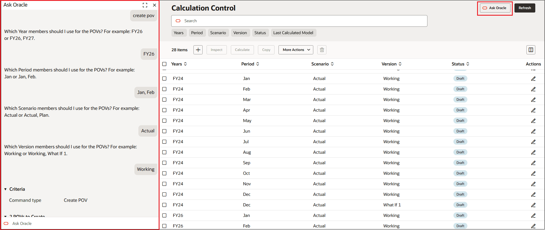

To open PCM Agent and create a point of view:
  1. Click Ask Oracle icon at the top of the Calculation Control page.
    PCM Agent is displayed on the left side of the page.
  2. Enter a create pov prompt in the Ask Oracle area at the bottom of the page.
    The PCM Agent assistant prompts you with the information required to create a point of view.
  3. After you have created a point of view, click Refresh at the top right of the Calculation Control page to display the new POV.
Figure 14-10 Sample Prompts to Create a Point of View
Calculation Control tab with prompts to create a POV using PCM Agent
