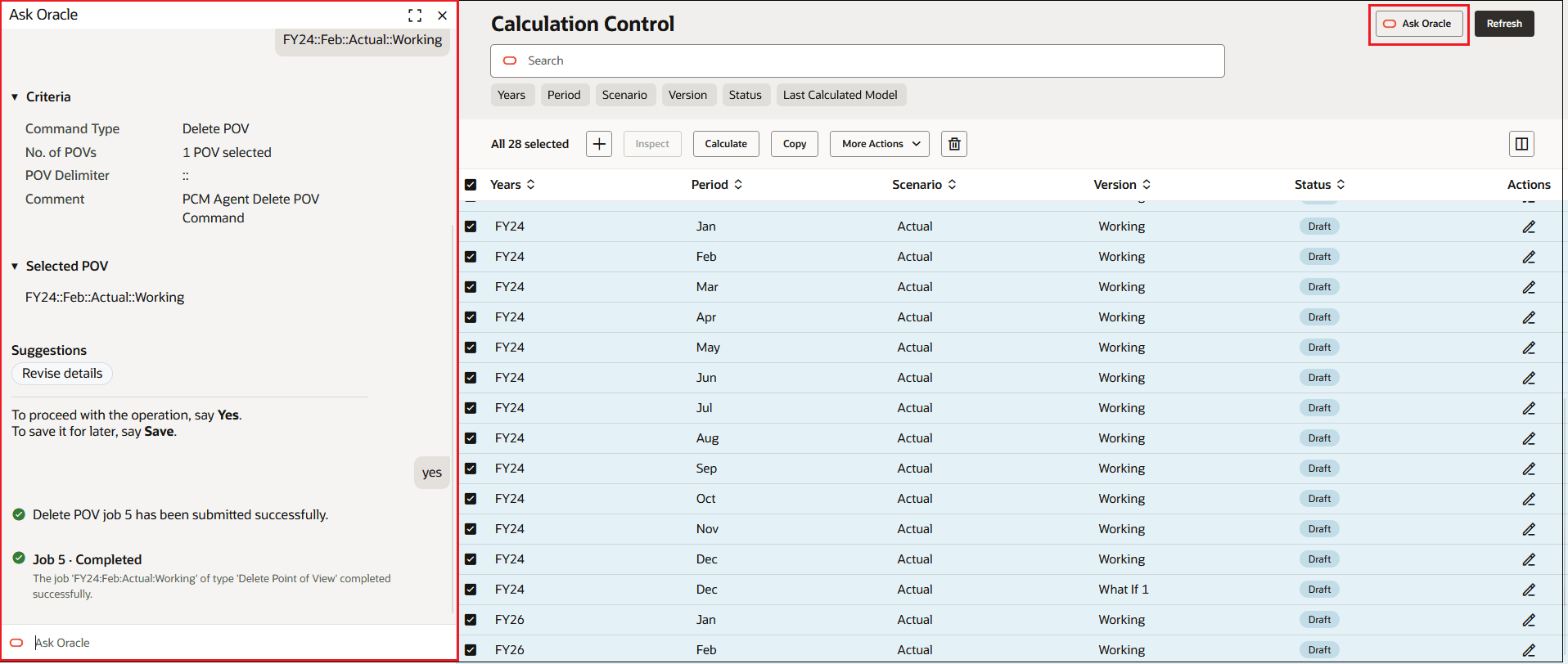

PCM Agent is embedded in the Calculation Control page, where you can use it to delete a point of view. It provides a true converstional experience where you are able to interact naturally with the assistant within the current workflow.
To open PCM Agent and delete a point of view:
  1. Click Ask Oracle icon at the top of the Calculation Control page.
    PCM Agent is displayed on the left side of the page.
  2. Enter a delete pov prompt in the Ask Oracle area at the bottom of the page.
    The PCM Agent assistant prompts you with the information required to delete a point of view.
  3. After you have deleted a point of view, click Refresh at the top right of the Calculation Control.
Figure 14-13 Sample Prompts to Delete a Point of View
Calculation Control tab with prompts to delete a POV using PCM Agent
