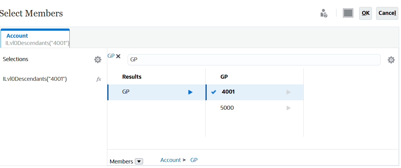

  3. In the Target Mapped Dimension(s), click Select under the dimension to which to apply the clear and restrict condition. Then from the Select Members page, select the member(s) to use for the clear and restrict option and then click OK.
    For example, you might select Gross Profit (GP) for the clear and restrict condition on the 4001 level 0 descendants as shown below:
    Image shows the Select Members page.

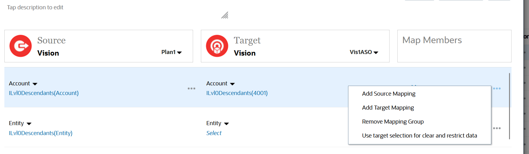

  4. Click Mapping Actions (Image shows Select icon.) next to the target member and then select Use target selection for clear and restrict data.
    Image show the Mapping page.

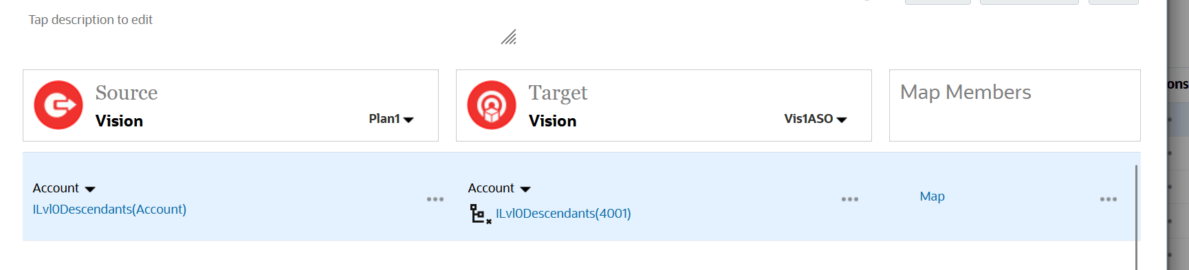

    When a target selection has been flagged for a target selection clear and restrict, a Image shows the clear and restrict icon. icon appears to the left of the flagged member as shown below:
    Image shows the Mapping page.
    In the example above, the data map clears only the level 0 descendants of 4001.

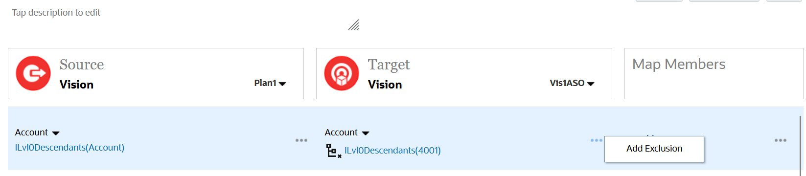

  6. To exclude a member from a target that has a clear and restrict condition, click Target Actions (Image shows Select icon.) and then select Add Exclusion.
    The Add Exclusion condition on the target is only available when the target has the option clear and restrict data enabled.

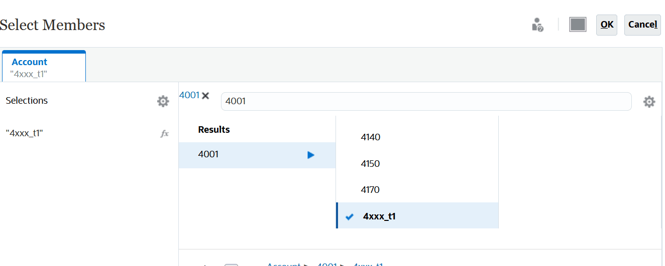

  7. On the Select Members page, select the member to exclude from the push and then click OK.
    Image shows the Select Member page.
    When a target member has been excluded from mapping, a Image shows Exclusion icon. icon appears to the left of the flagged member.
