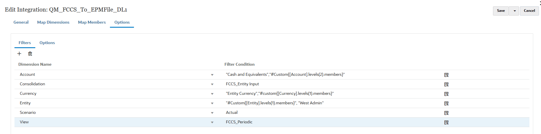

    The following example shows custom filters applied to the "Account," "Currency," and "Entity" dimensions:
    Image shows the Filters page.

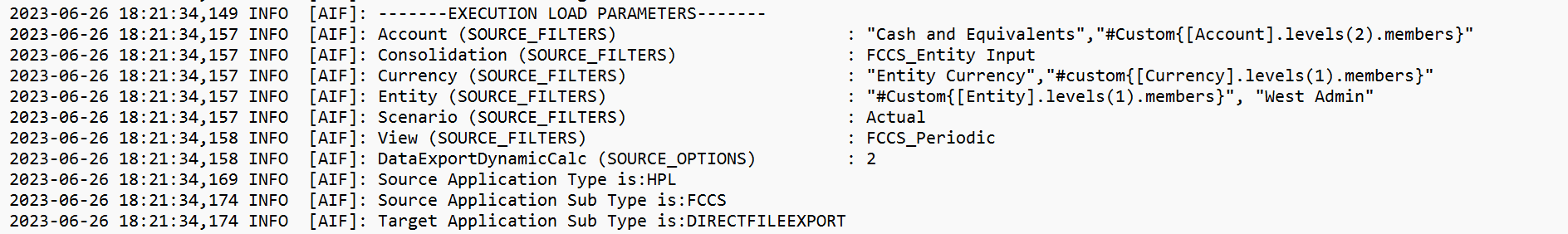

    In Process Details, you can view the details of the custom filters applied to the MDX query:
    Image shows the Process Details job.
