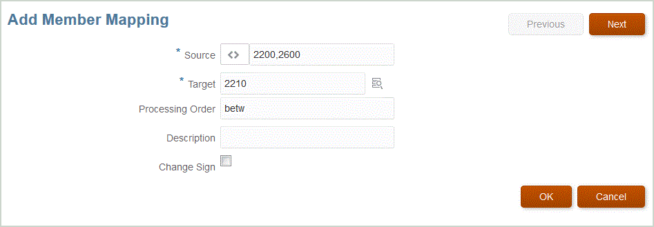

You can also just edit existing mappings as needed without adding a new mapping by selecting a mapping and clicking the Edit icon
From Add Member
Mapping page, then
Source, select the member
mapping type from the Mapping
Type drop down, and then specify the
source value.

When processing the source values for transformations, multiple mappings may apply to a specific source value. The order of precedence is: Explicit, Between, In, Multi-Dimensional, and Like. Within Between and Like types mappings, can overlap. - In Target, enter the target value for the dimension member name.
You can enter an individual member as target or select a value using member selector by clicking by clicking
- In Processing Order, specify the order of the mapping.
The processing order determines the level of precedence within a mapping type. Mappings are processed in alphabetical order by the name within a mapping type. Numbers may also be used to help with ordering. For example, if numbering by tens or hundreds, you can insert a new value between existing ones. When mappings are numbered 10, 20, and 30, you can add a mapping that starts with 25 and need not rename other mappings.
- In Description, enter a description of the mapping.
- Select Change Sign to reverse the sign of the target account specified.
The option is often used with General Ledger source data when the trial balance has negative signs for Revenue and Liability/Equity source accounts. In applications, numbers are often stored as positive values so you can use the change sign option to make the credit balances positive.
The Change Sign option is not supported for Quick Mode loads. - Click OK.
