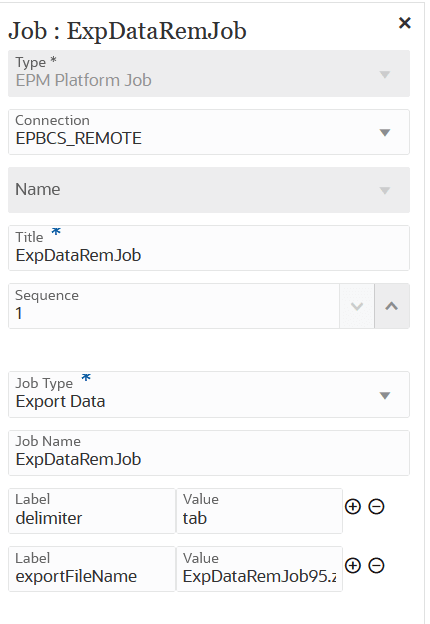

Here are the sample Export Data parameters for an EPM Platform Job job type:
Image shows Export Data job parameters for an EPM Platform job.

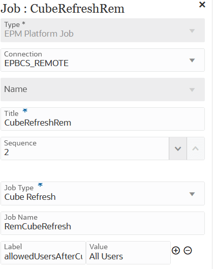

Here are the sample Cube Refresh parameters for an EPM Platform Job job type:
Image show Cube Referesh parameters for an EPM Platform Job job type.

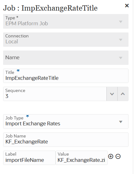

Here are the sample Import Exchange Rate job parameters for an EPM Platform Job job type:
image shows Import Exchange Rate job parameters.
