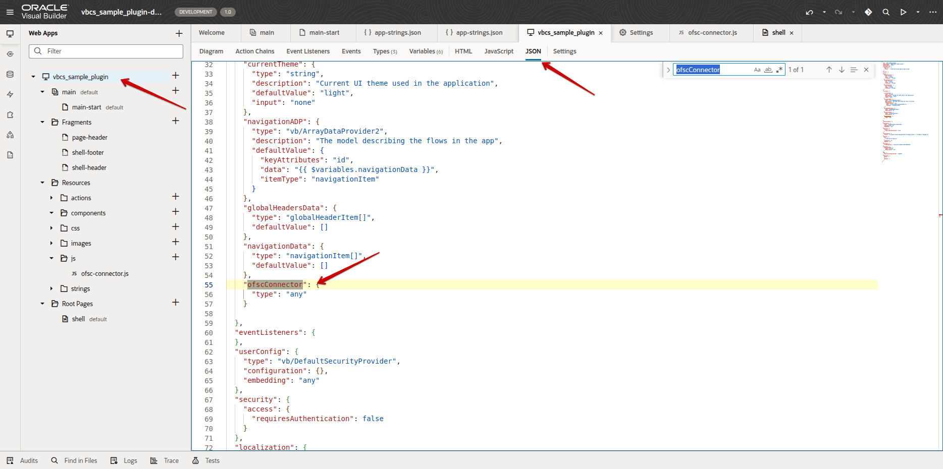

  3. Include a new file in the plugin.
    This screenshot shows the JSON tab in Visual Builder, where a new file is added:
    This screenshot shows a new file in the JSON tab of Visual Builder.

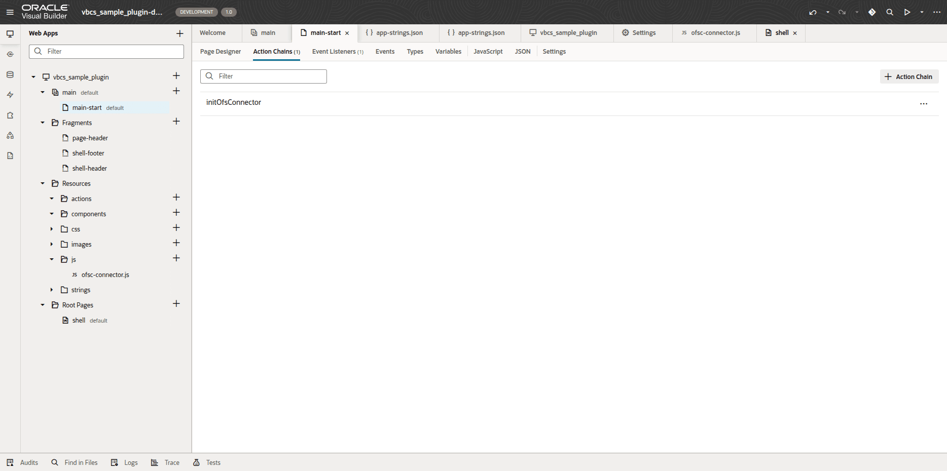

  4. Create a new Action Chain with the name initOFSConnector.
    This screenshot shows the new Action Chain, initOFSConnector:
    This screenshot shows the new Action Chain initOFSConnector.

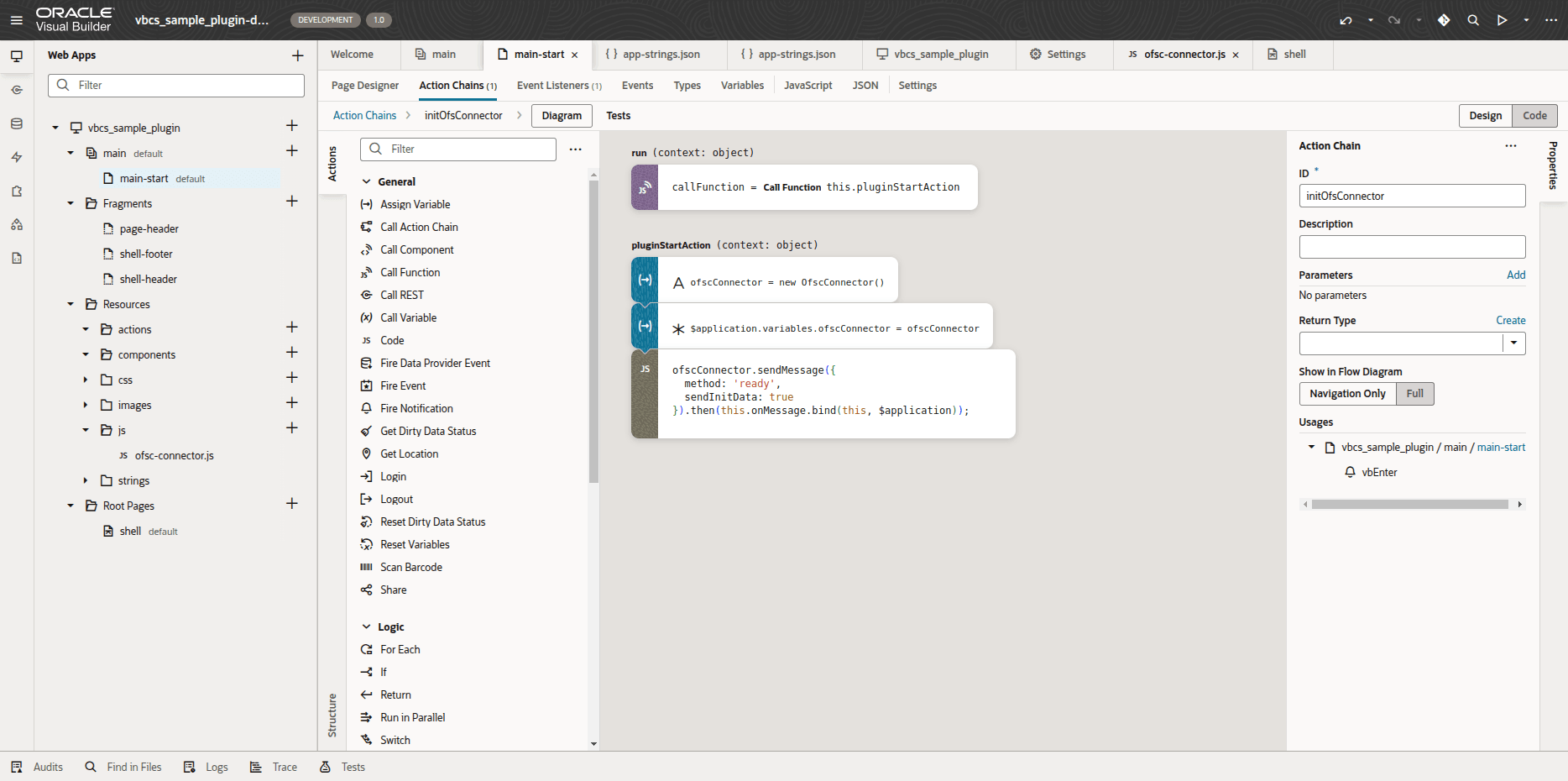

  5. Add the following chain using the UI or Code tab:
    • UI tab: This screenshot shows the new Action Chain added to the plugin using the UI:
      This screenshot shows the new Action Chain added to the plugin using the UI.
    • Code tab:
