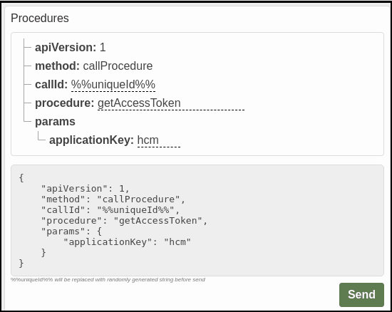

Obtain an Access Token
To acquire an access token using the Sample Plugin, you need to utilize the Procedures functionality as shown in the screenshot below. You can
  • Send a callProcedure method call to the plugin.
  • Within the callProcedure call, specify getAccessToken as the desired procedure.
This screenshot shows the procedure section.

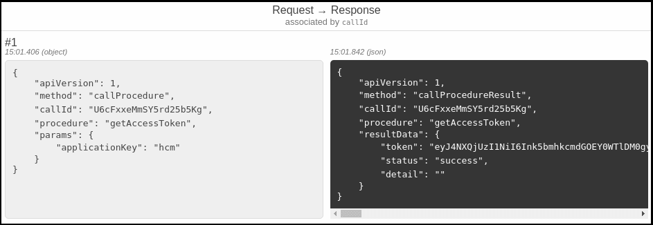

Retrieve the Token
Once the callProcedure with getAccessToken is processed, the resulting access token will be available in the callProcedureResult response method as shown below:
This screenshot shows the Request response method
