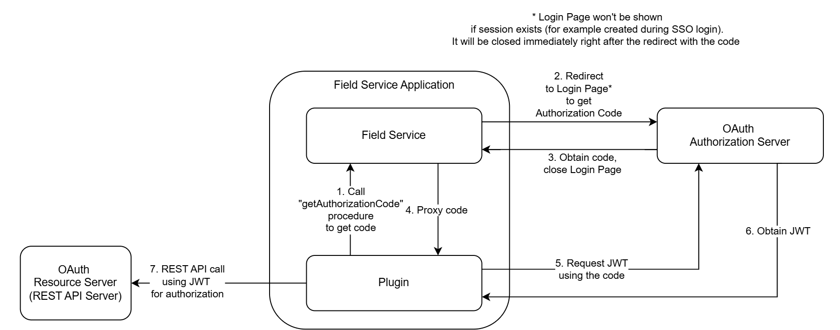

The OAuth Code Authorization flow in the Plugin API enables the acquisition of a JWT (access token) by using an already authenticated user session in Oracle Fusion Field Service through an Identity Provider. With the JWT access token, you must authenticate to the REST API of your Identity Provider to execute necessary actions, such as verifying user permissions, tracking data updates made by the user, and so forth.
The flow is detailed here:
  • Configure an application on an Identity Provider that supports the OAuth Code Authorization flow.
  • Use credentials such as Client ID, Scope, and Identity Provider endpoint to generate the URL to the Identity Provider Code Authorization endpoint.
  • Call the "getAuthorizationCode" procedure from the plugin with this URL in the procedure parameters.Obtain an authorization code in the procedure response.
  • Obtain a JWT access token by this authorization code from the plugin.
  • Use the JWT access token in the REST API request authorization.
Note: The JWT access token is issued on behalf of a user rather than an application.
This flowchart shows the OAuth Code Authorization Flow in Plugin API:
This flowchart shows the OAuth Code Authorization Flow in Plugin API.
