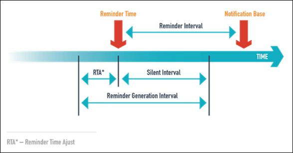

In order for the Reminder and Change messages to be sent, the Enable reminder and change triggers feature should be enabled for the corresponding activity type. At the same time, both launch conditions can be called only for a pending ordered activity (regular or reopened) in an activated route on the current working day. The Reminder message is generated within the time period from Reminder Time + Reminder Time Adjust to Reminder Time – Reminder Silent Interval before the activity Notification base. This flowchart shows the relationship between the Reminder Interval between the Reminder Time and the Notification Base changes. This process is described in the paragraphs above and below.
The Reminder time is defined on the activity level using the Reminder field in the Activity details screen. When the Reminder time is set to 0, the Reminder launch condition is disabled for the selected activity. The Reminder Time Adjust is the system predefined time shift for the reminder, which is used to eliminate the delay in message processing. For example, if Reminder Time Adjust = 3 minutes and Reminder Time = 60 minutes, the reminder will be generated 63 minutes before the Notification base. The value of Reminder Time – Reminder Silent Interval defines the minimal time before the Notification base is to generate the Reminder.
