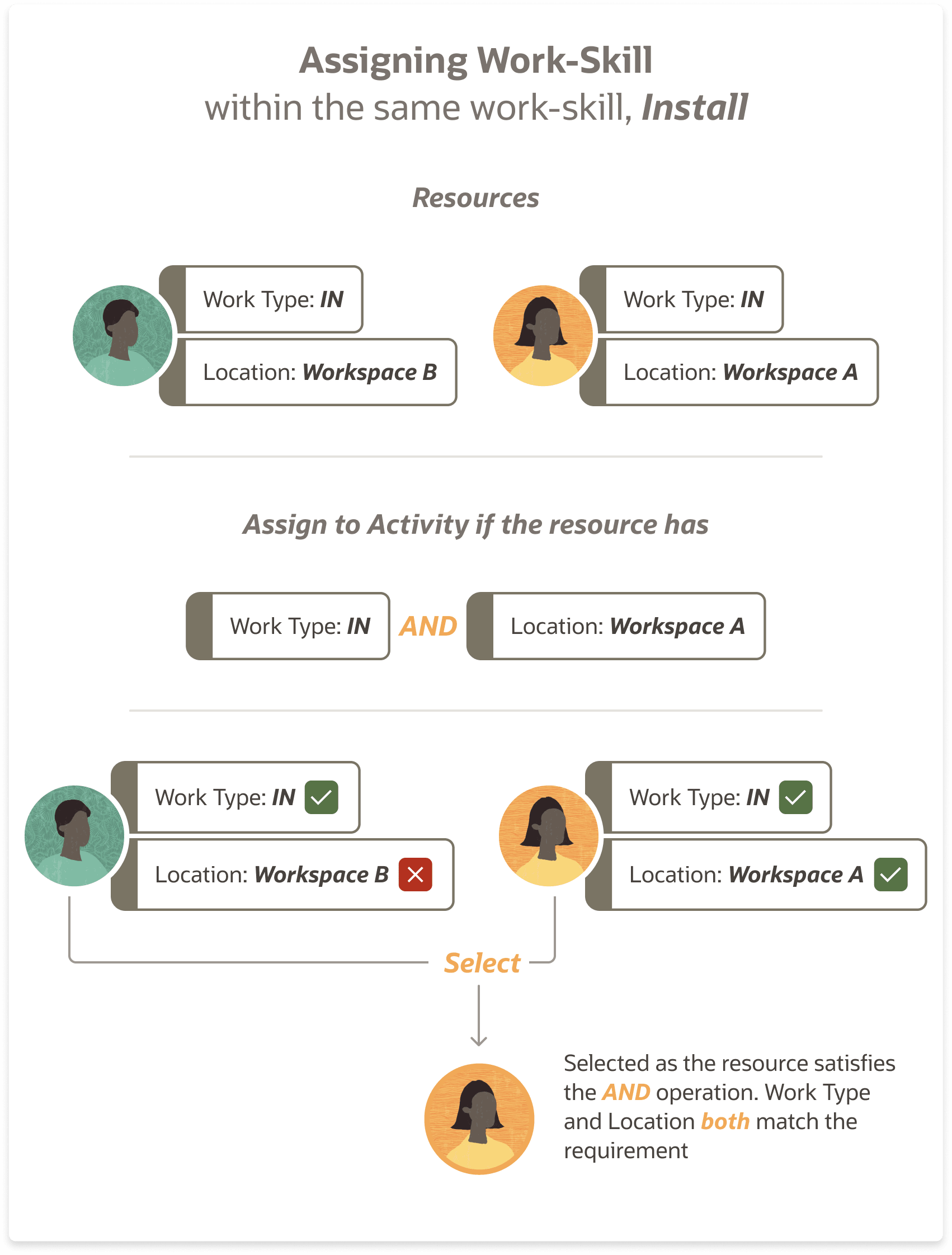

    When a new activity is added, these work skill conditions are used to determine which work skills are assigned to the activity. If two conditions are added to the same work skill condition, they are processed using the AND operator.
    For example, suppose you want the work skill Install to be assigned to a mobile worker who has a minimum skill level of 75, for work order types IN. Select the Work skill name as Install, enter 75 for Required level, click Add new condition and then select W/O Type, In, and IN.
    This screenshot shows the AND condition

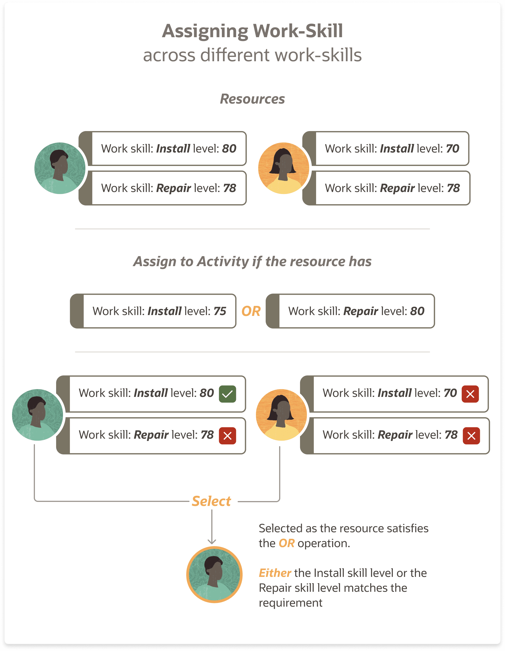

    However, if the conditions are included in different work skill conditions, they are processed using the OR operator.
    This screenshot displays the OR condition.
