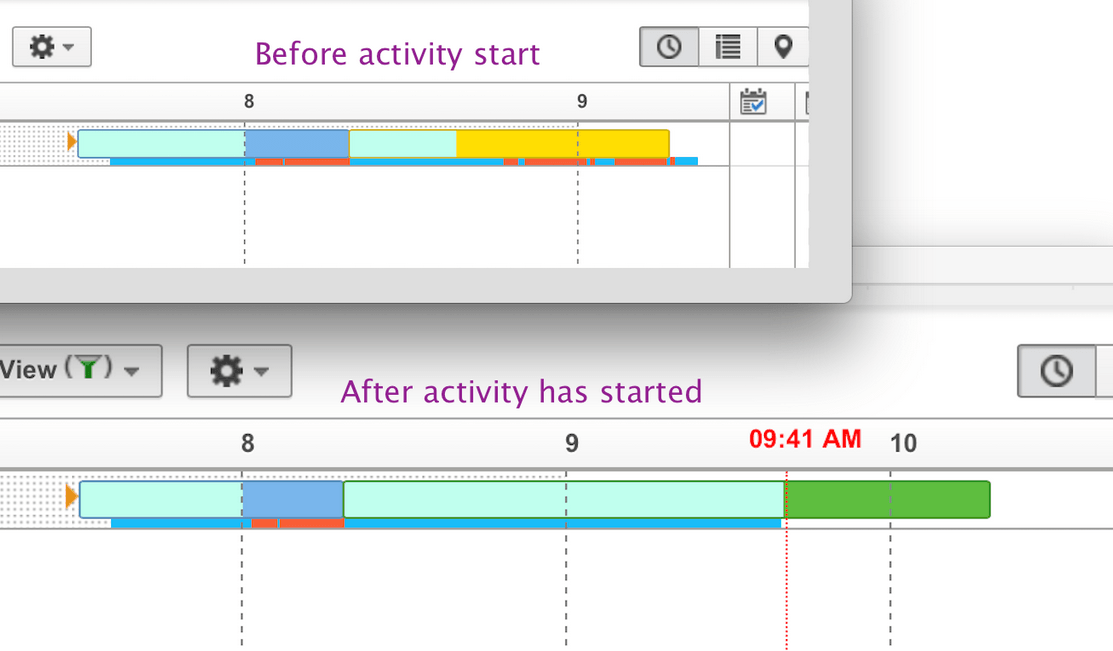

  • This figure shows an example of Time view before and after mobile worker starts an activity. Image shows Time view before and after Mobile Worker started the activity

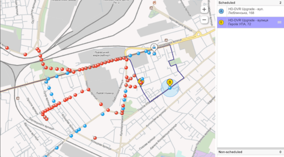

  • Now, the ETA for the second activity was approximately 08:30 AM. In fact, it was started at 09:40 AM. Time View is updated immediately after the tech started the activity. The resource coordinates collected within estimated activity duration are mostly red since the mobile worker is progressed to be out of activity:
    • This figure shows resource coordinates after the Mobile Worker started the activity: Image shows the status to indicate that the Mobile Worker is busy with the started activity.

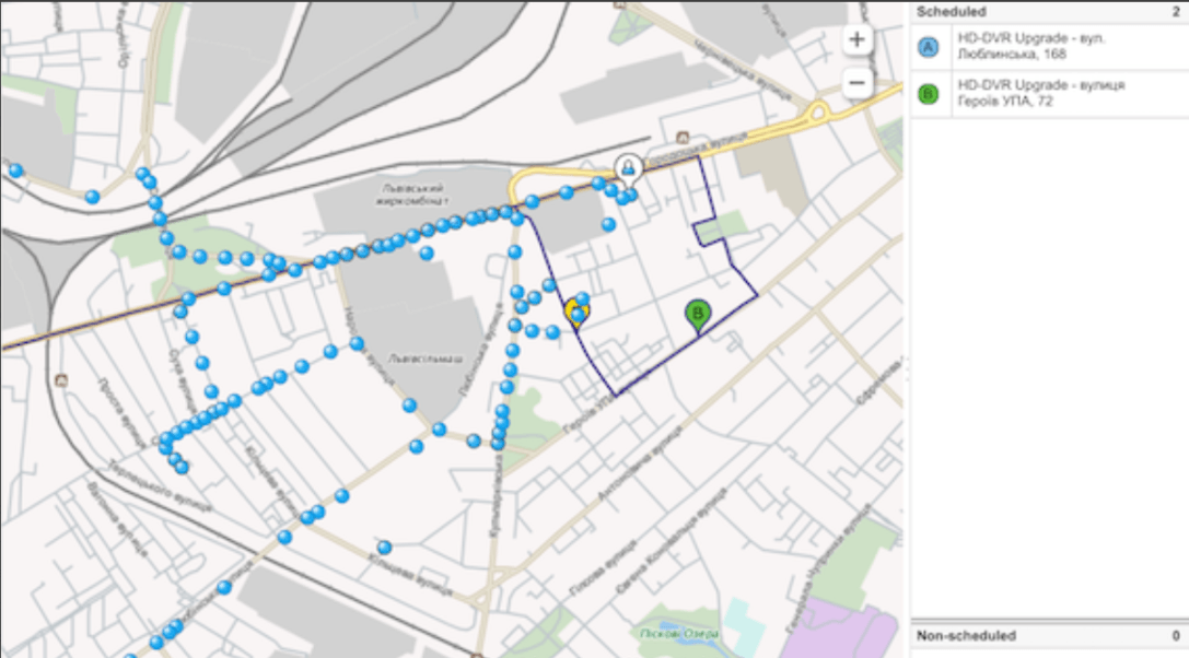

    • The situation changes when the mobile worker suspends the first activity. The resource coordinates turn blue (normal) because the mobile worker is traveling to the second activity.
    • This figure shows resource coordinates after the mobile worker suspended the first activity: Image shows the change in status to indicate that the Mobile Worker is traveling to the activity (normal status).
