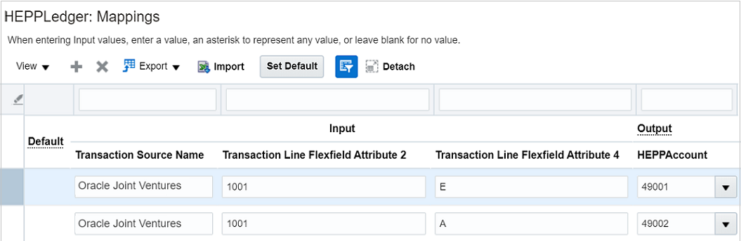

The following image shows the Edit Mapping Set page for a mapping set that has "Joint Venture Expense Reimbursement Account" as the name and description, and output type "Segment." The input sources selected for the mapping set are: Transaction Source Name, Transaction Line Flexfield Attribute 2, and Transaction Line Flexfield Attribute 4.
The following image shows the Mappings section of the page. It includes two mapping set rows with the values "Oracle Joint Ventures" in the Transaction Source Name column and "1001" in the Transaction Line Flexfield Attribute 2 column. This means that the system will map output values only for joint venture invoices that are created for the cost center 1001. The Transaction Line Flexfield Attribute 4 shows different values for each row. The value of E (Expense) in this column indicates that all joint venture invoices that are created to reimburse the operating expenses for cost center 1001 will be recorded in the natural account 49001. The value of A (Assets) in the second row indicates that the joint venture invoices created to reimburse the capital expenditures for cost center 1001 will be recorded in the natural account 49002.

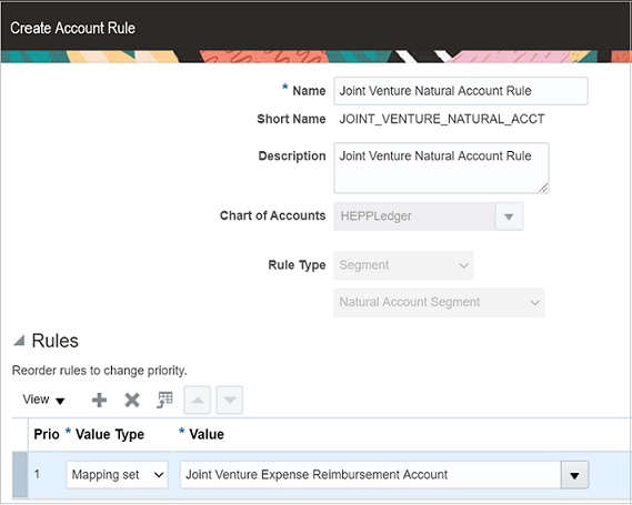

Create an account rule to assign the mapping set that you created in the preceding task.
Navigate to Setup and Maintenance and select the Receivables functional area.
Select Show – All Tasks and then click the Manage Account Rules task.
On Manage Account Rules: Receivables, click Create.
On Create Account Rule, enter the following details:
Name.
Short Name.
Chart of Accounts. Select the chart of accounts of the primary ledger of your joint venture.
Rule Type. Select Segment.
Then, for the chart of accounts you selected, select the natural account segment value from the drop-down list.
In the Rules section, click Add and enter the following details:
Value Type. Select Mapping set.
Value. Select the name of the mapping set that you created in the preceding task.
Click Save.
The following image shows the Create Account Rule page with information entered to create an account rule with the Rule Type “Natural Account Segment.” A mapping set is specified in the Value field. This indicates that the mapping set referenced in this account rule is for the natural account segment for receivables invoices.

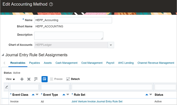

The Edit Accounting Method page is displayed for the accounting method you created.
The following example shows an accounting method for a chart of accounts.
In the Journal Entry Rule Set Assignments section for Receivables, check if a record already exists for event class “Invoice” and event type “All”. If it exists, click the rule set to edit the credit line. If it doesn’t, you need to create the record. To do so, click Add (+ icon) and enter the following details:

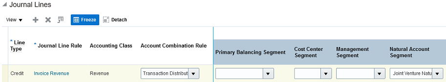

Under Journal Lines, you can add a new journal line or edit existing journal lines.
Note: If this is an existing rule set, it might already contain a journal line for Credit line type and Invoice Revenue journal line rule. If this is the case, you just need to edit the journal line to assign the correct account rule in the Natural Account Segment field.To add a new journal line, click Add and enter the following details:
Line Type. Select Credit.
Journal Line Rule. Select Invoice Revenue.
Account Combination Rule. Make sure this field is populated with the default account rule, Transaction Distribution GL Account.
Natural Account Segment. Search and select your account rule that you created to derive the natural account segment of the partner account for joint venture invoices.
Click Save and Close.
The following image shows a journal entry rule set that’s set up with an account rule in the Natural Account Segment column. This account rule will derive the natural account with the account specified in the associated mapping set.
Verify that the journal entry rule sets for the other systems that you stored in this accounting method are intact.
To activate the journal entry rule set, click Activate.
Make sure the status of the accounting method is Active and then save it.
