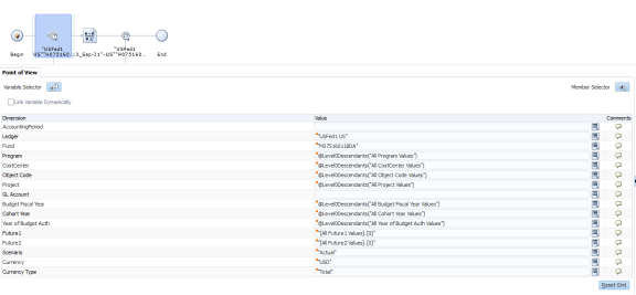

From the New Objects list, select the Point of View object and then drag and drop it between the Begin and End components in the flow chart in the Designer area.
The dimensions appear based on your ledger and the balances cube.
- Set up the dimensions for the point of view. To set a dimension value:
- Click the Select icon next to the Value field and then select Member, or select Variable to select a runtime prompt variable.
- On Member Selector, select a member and move it to the Selections panel. If you selected Variable in the previous step, select the variable.
- Click OK.
The following table describes example values for the dimension fields:
Example Dimension Values
Field Value AccountingPeriod It’s recommended that you create a runtime prompt variable component for the rule so that the user is prompted to specify the period to use in the allocation calculation when the rule is run. This will also ensure that the rule doesn't have to be changed at the end of each fiscal year. This example uses a runtime prompt variable, AccountingPeriod. Ledger The ledger to be closed, for example, USFed1 US. Fund If you’re using this rule only for one fund, set this to the fund value. If you’re using this rule to close the account for all funds in the ledger, right-click All Fund Values, click Add Special, and then select Level0Descendants.Note: Level0Descendants acts as a wildcard and if you select it, all the available values are selected and processed.Program @Level0Descendants("All Program Values") CostCenter @Level0Descendants("All CostCenter Values") Object Code @Level0Descendants("All Object Code Values") Project @Level0Descendants("All Project Values") GL Account The account that will be used for the rule. For this example, this is defined when configuring the formula object. Budget Fiscal Year @Level0Descendants("All Budget Fiscal Year Values") Cohort Year @Level0Descendants("All Cohort Year Values") Year of Budget Authority @Level0Descendants("All Year of Budget Auth Values") Future1 Select 0 to be used as the default, for example, "[All Future1 Values].[0]" Future2 Select 0 to be used as the default, for example, "[All Future2 Values].[0]" Scenario "Actual" Currency "USD" Currency Type "Total" Here’s how the Point of View object looks like after you define the dimensions:

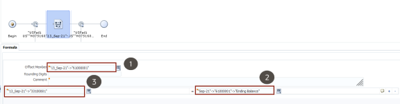

- Next, select the Formula object from the New Objects list, and then drag and drop it after the Point of View object in the flow chart in the Designer area.
- Set up the Formula object to define the source account
(1), source amount (2), and target account (3) for the closing journal. To
define the source and target values, click Select next to
the field and then set up the dimension values.
The following table and the image that follows it describe example values for the formula fields:
Example Formula Values
Field Description Value Offset Member (1) This is the source GL account where the funds originate. This is the account from where the funds will be moved. Set the values for the GL Account and AccountingPeriod dimensions, for example, AccountingPeriod = 13_Sep-21 and GL Account = 61000001. Source (2) This is the source amount that will be allocated. Set the values for these dimensions: - Accounting Period: Set this to the last period of the fiscal year, for example, Sep-21.
- GL Account: This is the GL account you're closing. In this example, it’s 61000001.
- Balance Type: Set this to Ending Balance to close the balance of the account to $0.
Target (3) This is the GL account to which the funds will be moved from the source account. Set the values for these dimensions: - AccountingPeriod: Set this to the closing adjustment period of the fiscal year.
- GL Account: This is the GL account you're moving the funds to. In this example, it’s 33100001.
Here’s an example of how the Formula object looks like:
