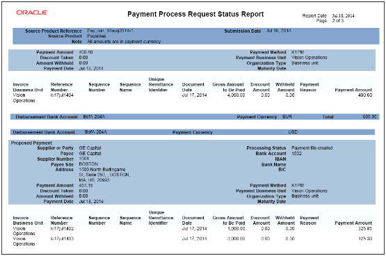

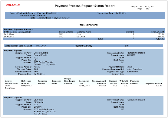

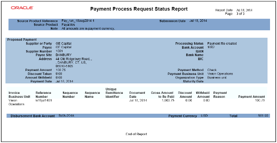

The following figure is an example of a 3-page Payment Process Request Status report.
