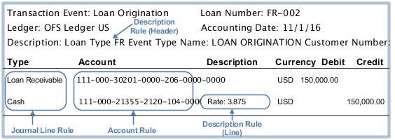

Using the example of a loan origination transaction type, determine what are the sources that store the transaction information for a journal entry? Visualize the journal entries that you would like to create for a loan origination transaction type and list all the sources for its transaction information.
This table contains a journal entry, with Side, Accounting Class, Accounting and Debit and Credit amounts.
Side
Accounting Class
Account
Debit
Credit
Debit
Loan Receivables
111-000-30201-0000-206-0000-0000
500,000 USD
None
Credit
Cash
111-000-21355-0000-104-0000-0000
None
500,000 USD
  • In the table the example identifies the sources for the journal lines and accounts in a source system:
    • Each debit and credit journal line is identified and defined for each transaction type.
    • When a loan is originated, the loan receivables account is debited, and cash account is credited.
    • The cost center segment of the Loan Receivables accounts can have two values, depending on the loan type value:
      • If the loan type is adjustable rate, then the cost center is '0000'.
      • If the loan type is fixed rate, then the cost center is '2120'.

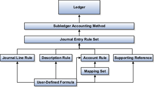

4. Analyze the Configuration of Accounting Rules in Accounting Hub
With the analyzed transaction information and subledger model completed, evaluate the usage of accounts rules. Understand the functional usage for each rule component and the requirements for accounting and reporting.
Journal Entry in Source System
This figure illustrates a journal entry.
This figure illustrates a journal entry component created using a description rule, journal line rule, and account rule.
Accounting Rule Configuration in Accounting Hub
This image illustrates the subledger flow as detailed in the Manage Accounting Rules topics.
This image illustrates the subledger flow described in the Manage Accounting Rules topics.
