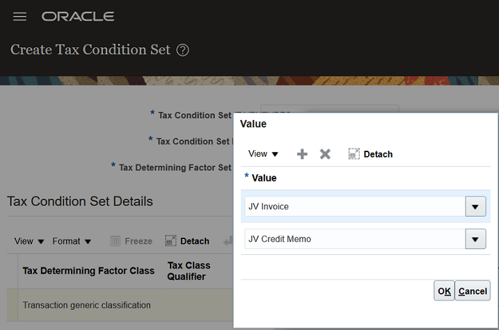

    The following image shows that the Value dialog box opened on the Create Tax Condition Set page. The joint venture transaction types for invoice and credit memo are selected as the transaction types to associate with the tax condition set.
    This image shows the Value dialog box opened on the Create Tax Condition Set page. The details of the values entered in the fields are described in the surrounding text.
