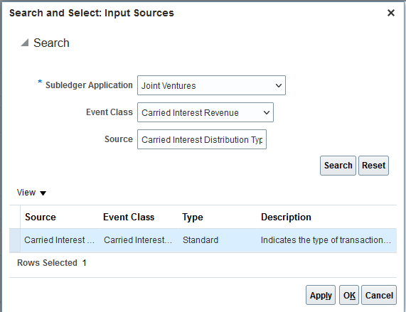

Note: The Subledger Application field is set to Joint Ventures by default and can’t be changed. This is because the Manage Mapping Sets task, when accessed from the Joint Venture Management functional area, is designed specifically for setting up journal entries in the Joint Venture subledger. Identify the input source: In the Input Sources area, click “Select and Add” and then complete these fields to search and select the input source:
- In the Input Sources area, click “Select and Add” and then enter these
values to search for the input source:
- Event Class. Select Carried Interest Revenue.
- Source. Enter Carried Interest Distribution Type.
- Select the Carried Interest Distribution Type row in the results and click OK.

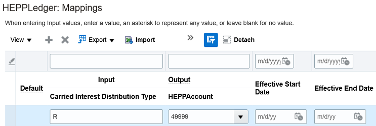

- In the Mappings area, add a row to map the revenue transaction type from carried interest journals to the cutback account:
- Carried Interest Distribution Type. Enter R for Revenue.
- HEPPAccount. Select the cutback account.
The following image shows an example of the mapping for the carried interest distribution type.
Notice in this example, HEPPLedger in the Mappings heading indicates the chart of accounts of the primary ledger of the joint venture. The mapping set is used to map revenue carried interest distributions to the cutback account 49999, which is specified in HEPPAccount segment in this example.

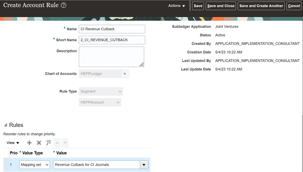

Create an account rule to enable lines within carried interest journals to be entered as a debit in the revenue cutback account for a joint venture. You associate the mapping set created in the preceding task to this account rule.
- In the Joint Venture Management functional area in FSM, select Show – All Tasks and then click the Manage Account Rules task.
- On Manage Account Rules: Joint Ventures, click Add.
- On Create Account Rule, complete these fields:
- Name.
- Short Name.
- Description.
- Chart of Accounts. Select the chart of accounts of the primary ledger of your joint venture.
- Rule Type. Select Segment from the drop-down list.
- Click the field that appears below the Rule Type field and select the natural account segment value from the drop-down list.
- In the Rules area, click Add and specify the following values in the first
row:
- Value Type. Select Mapping Set.
- Value. Select the mapping set that you created in the preceding task.
- Click Save and Close.
The following image shows an example of a new account rule that’s defined with a mapping set named Revenue Cutback for CI Journals. The rule type for the account rule is Segment, which enables it to derive the value for the HEPPAccount segment in the HEPPLedger chart of accounts.

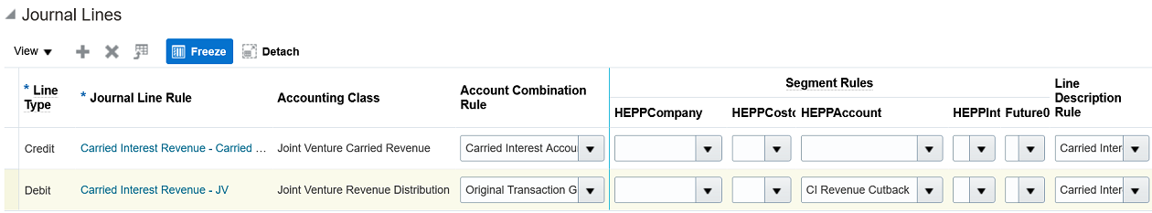

- On Edit Subledger Journal Entry Rule Set, access the Journal Lines area and
highlight the Debit row for deriving the revenue cutback account.
The columns in the Segment Rules represent the segments in the primary ledger for identifying the accounts that contain the original joint venture transactions.
- In the column representing the natural account segment of the chart of accounts,
select the account rule that you set up in the preceding task.Caution: Do not change the Credit row.
The account rule contains the mapping set that ensures that amounts in carried interest journals are entered into the appropriate revenue cutback account.
The following example shows a Debit journal line rule, in which the HEPPAccount column represents the natural account segment of the chart of accounts. An account rule named CI Revenue Cutback was selected for the HEPPAccount. The Credit journal line rule was not modified because by default, the account is defined to credit carried interest amounts to the consenting stakeholder accounts.
