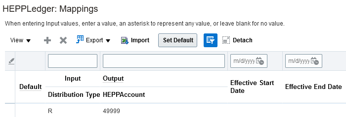

In the Mappings area, add a row to map the revenue transaction type from internal transfer journals to the cutback account, as shown in the following example:
Notice in this example, HEPPLedger in the Mappings heading indicates
the chart of accounts of the primary ledger of the joint venture. The
mapping set is used to map revenue distributions from a joint venture to the
cutback account 49999, which is specified in HEPPAccount segment in this
example.

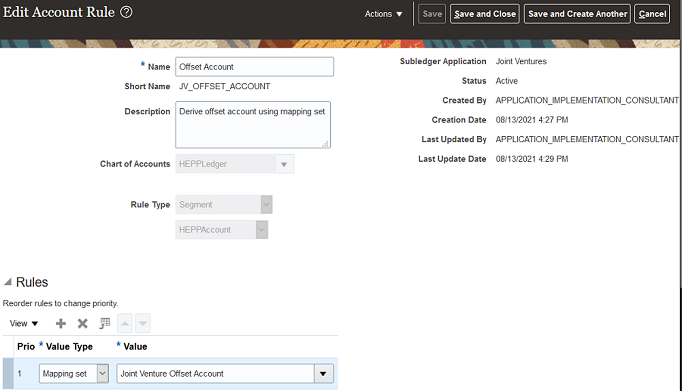

The following image shows an example of a new account rule that’s defined with a mapping set.
In this example, the account rule is created for and associated with a mapping set named Joint Venture Offset Account. The rule type for the account rule is Segment, which enables it to derive the value for the HEPPAccount segment in the HEPPLedger chart of accounts.

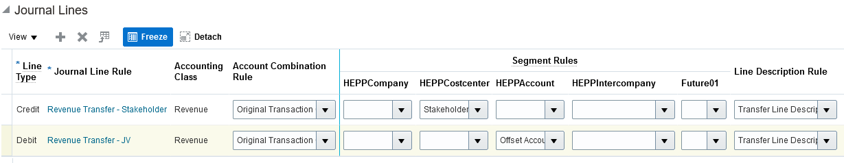

On Edit Subledger Journal Entry Rule Set, access the Journal Lines area and highlight the Debit row for deriving the revenue cutback account.
The columns in the Segment Rules represent the segments in the primary ledger for identifying the accounts that contain the original joint venture transactions. -
In the column representing the natural account segment of the chart of accounts, select the account rule that you set up in the preceding task.
The account rule contains the mapping set that ensures that amounts in internal transfer journals are entered into the appropriate revenue cutback account.
The following example shows a Debit journal line rule, in which the HEPPAccount column represents the natural account segment of the chart of accounts. An account rule named Offset Account was selected for the HEPPAccount. The Credit journal line rule was not modified because by default, it’s set up to use the cost center of the stakeholder to credit internal transfer amounts to the stakeholder accounts.
