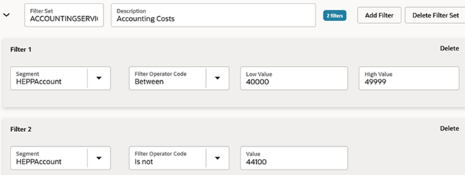

In this example, the partners in a joint venture dispute the charges for a particular set of costs that they were billed in the 1st quarter of the calendar year. They maintain that the costs weren't part of the joint operating agreement.
The joint venture accountant researches the joint venture setup and discovers that an account shouldn’t be included in the account set for identifying distributable accounts for the joint venture. The accountant corrects the setup issue so that no further transactions with the account information are distributed. The following image shows how the accountant corrected the issue in the account set. The accountant added a second filter to exclude the account that isn’t distributable.
This image shows a filter set with two filters, the purpose which is described in the surrounding text.
The image shows that in segment HEPPAccount, all accounts with values between 40000 and 49999, except for account value 44100, are set as distributable for the joint venture.

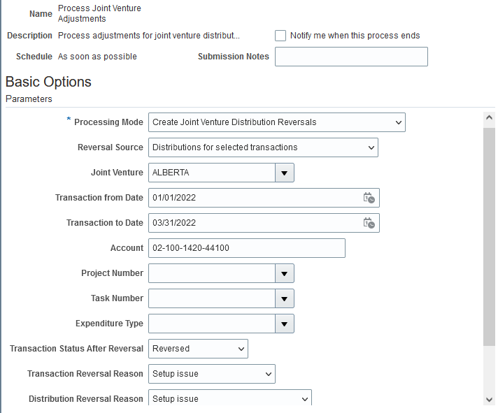

Next, the joint venture accountant runs the adjustments process to reverse the distributions that were billed in error. In the “Process Joint Venture Adjustments” process, the accountant completes the following parameters to identify the transactions whose distributions need to be reversed:
Parameter Value
Processing Mode Create Joint Venture Distribution Reversals
Reversal Source Distributions for selected transactions
Joint Venture Alberta
Transaction from Date 01/01/2022
Transaction to Date 03/31/2022
Account 02-100-1420-44100
Transaction Status After Reversal Reversed
Transaction Reversal Reason Setup issue
The following image shows the completed parameters in the adjustments process:
This image shows the Process Joint Venture Adjustments process. The parameters in the image that pertain to the example are described in the surrounding text.
The adjustments process performs these actions on the distributions associated with the transactions identified by the process:
  • Marks the invoiced distributions as Canceled in the Distribution Line Type column.
  • Creates a reversed distribution for each canceled distribution to cancel out the original distribution amount.
    Reversed distributions include the reason for the reversal, which is derived from the reason that the accountant selected in the adjustments process—"Setup issue.”
  • For the transactions whose distributions were reversed, it updates the transaction status to Reversed so that the transactions can’t be distributed again.
The accountant then runs the processes to complete the accounting of the reversed distributions.
