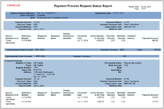

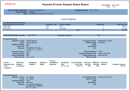

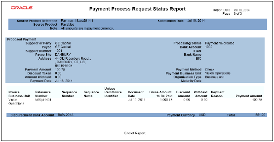

The Payment Process Request Status report is a predefined disbursement report that displays the details of all the payments generated in a specific payment process request. You can use the report to verify the payments created in a payment process request.
The following figure is an example of a 3-page Payment Process Request Status report.
