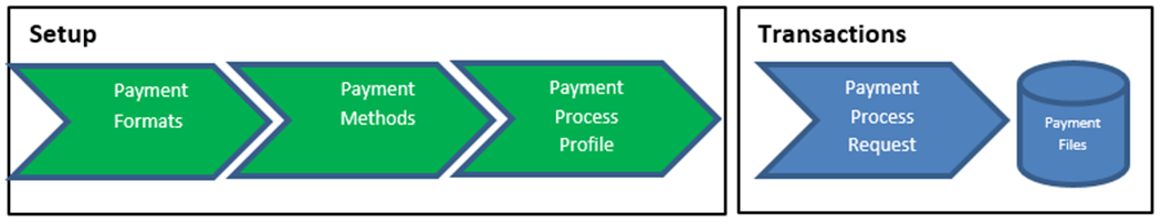

The Create and Extract Brazil Electronic Payment Files process is composed of a onetime configuration that provides all the required configuration data. You can run the Payment Process Request process to create payment files.
This image outlines the overall
steps to generate electronic payment files:
The main configuration steps to configure and generate electronic payment files for Brazil are as follows:
- Payment formats for Brazil
- Payment methods for Brazil
- Payment process profile
Once the configuration is done, the Submit Payment Process Request job can be executed.

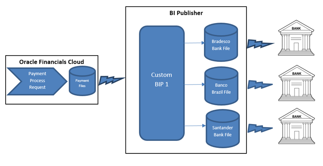

Integration - Creating Electronic Payment Files to Payer Bank Specific Formats
Oracle Financials Cloud provides an out-of-the-box payment file extract to export the payments from Oracle Cloud to the on premises financial system. For additional bank specific files formats, the implementation team must devise a strategy and build the export file using the Business Intelligence Publisher (BI Publisher) based on payments that are created. The following figure illustrates this flow:
To create user-defined BI Publisher reports that support bank specific formats, follow these steps:
