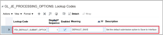

    For example, to set the default submission option to Save to Interface, enter DEFAULT_SAVE for the meaning and Set the default submission option to Save to Interface for the description.
    Here's a partial image of the lookup code entry for this example.
    An image of the FDI_DEFAULT_SUBMIT_OPTION lookup code for the GL_JE_PROCESSING_OPTIONS lookup type.
  4. Save your changes.
