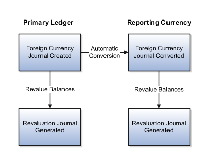

Here's a high-level view of the five journals that are going to be created in the primary ledger and reporting currency.
Now let's look at the details.

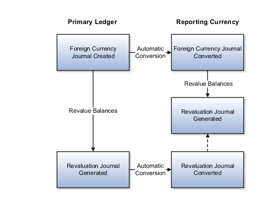

Here's a high-level view of the four journals that are going to be created in the primary ledger and reporting currency.
