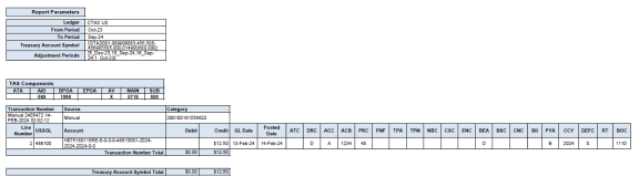

The GTAS Transaction Register Report is generated when you run the GTAS Accumulation process with the Run Transaction Register parameter set as Yes.
This report lists all the journals that are summarized and reported in the GTAS bulk file. The report includes USSGL journal line activity at the GTAS attribute level of detail.

Here’s an example of the GTAS Transaction Register Report generated using sample data:
