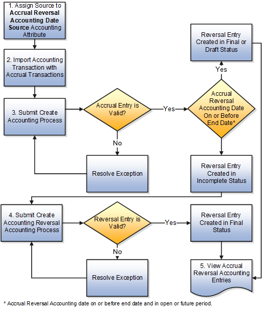

Accrual Reversal Process Steps
This flow chart shows the accrual reversal process in Accounting Hub.
End Date: The date till when the Create Accounting process selects accounting events for processing.
Assign a date source to the Accrual Reversal Accounting Date Source accounting attribute at the event class level.
Use this attribute to schedule the automatic reversal of a journal entry. On the Manage Accounting Attributes page, assign any standard date source or one of these application sources to the Accrual Reversal Accounting Date Source accounting attribute as a nondefault assignment:
Next Day: The accounting date of the accrual reversal is the next day following the accounting date of the accrual entry.
First Day of Next Accounting Period: The accounting date of the accrual reversal entry is the first day of the following accounting period.
Last Day of Next Accounting Period: The accounting date of the accrual reversal entry is the last day of the following accounting period.
Note:If a default source is assigned to the Accrual Reversal Accounting Date Source accounting attribute, it will be assigned to all the journal entry rule set defined for the event class.
Define a journal entry rule set for the event type for which you would like to use the accrual reversal feature and select an accrual reversal accounting date source.
Import Accounting Transaction with accrual transactions.
The Import Accounting Transaction process automatically submits the Create Accounting process that creates both accrual and reversal journal entries.
If that accrual entry has exceptions, you must resolve the exceptions and then manually submit the Create Accounting process again.
For all valid accrual journal entries, the Create Accounting process also creates the accrual reversal journal entry. Reversals can either be done by switching the debit and credit side on entries or by using negative amounts. You use the Reversal Method option on the Manage Subledger Accounting Options page to specify the method to use for reversals.

Submit Create Accrual Reversal Accounting to process any incomplete accrual reversal journal entries. This process validates the reversal entry and changes the reversal entry to Final status, if it passes validation.
Schedule the Create Accrual Reversal Accounting process to run automatically in each accounting period. As a best practice, run before closing the period.
View accrual reversal accounting entries.
