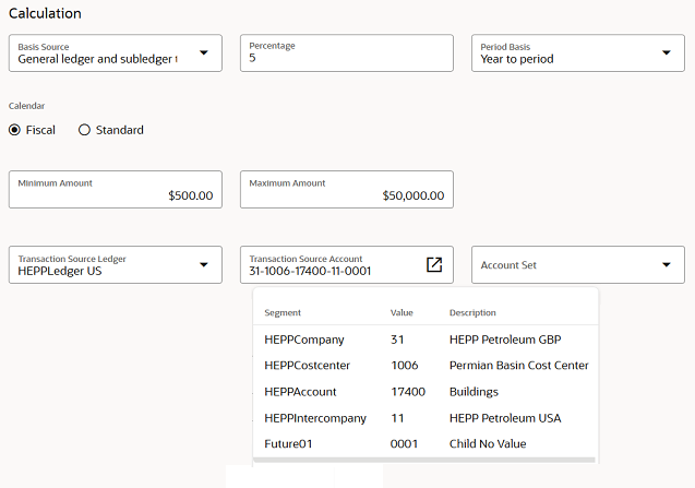

- In the Calculation area, for the Basis Source, select General ledger and subledger transactions.
Enter a percentage to use for the overhead calculation, or if you want to enter
percentages in a sliding scale, select Use Sliding Scale.
Note: A percentage can have up to 6 decimal places. A percentage with more than 6 decimal places is not rounded and will be truncated, for example 10.123456789% will be truncated to 10.123456.

For the Period Basis, select one of these options:
Inception to period. Select to base overhead calculations on transactions from the inception of the joint venture to the period specified in the process to calculate overhead.
Period. Select to base overhead calculations on transactions in the period specified in the process to calculate overhead.
Year to period. Select to base overhead calculations on transactions from the beginning of the year to the period specified in the process to calculate overhead.
For the Calendar, select Fiscal or Standard to specify if overhead is to be
calculated based upon your fiscal calendar or the standard calendar (January -
December).
This helps to ensure that the appropriate transactions are selected.
When calculating overhead from general ledger and subledger transactions, in
addition to a minimum amount, you can enter a maximum amount of overhead to bill
joint venture partners:
Minimum Amount. You can enter a minimum amount to include in the transaction if the calculated amount is less than this amount.
Maximum Amount. You can enter a maximum overhead amount to be billed to joint venture partners. The process to calculate overhead keeps a running total of overhead amounts calculated over the period basis selected in the overhead method. Overhead amounts that exceed the maximum amount will not be billed.
To identify the source of the transactions for the overhead calculation, use
the following transaction source fields or an account set:
To use the transaction source fields:
- Select a ledger from the Transaction Source Ledger list. You can narrow the list to choose from by typing in the first few characters of the ledger name.
Click the Transaction Source Account field and then choose from a list
of segment values that make up the account ID. Or click the "Search for
combination" icon and use segment filters to identify the account
ID.
The following image shows a transaction source account and how the application displays the name and description of each of the segment values that make up the account ID, which in this example is 31-1006-17400-11-0001.
To use an account set, select an account set from the Account Set list.An account set, which you set up separately, contains filter criteria for identifying transactions for processing in Oracle Joint Venture Management. See Overview of Joint Venture Account Sets for more information. -
