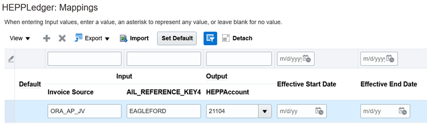

The following example shows a mapping set to define a liability account with the following values selected for the input sources:
  • Subledger Application = Payables
  • Event Class = Invoice
  • Source = AIL_REFERENCE_KEY4
    The source is one of the predefined reference keys, which you can select one or more for the input source.
The following image shows the Mappings section with values entered for the input and output sources. The two input columns named Invoice Source and AIL_REFERENCE_KEY4 are mapped to the values ORA_AP_JV and EAGLEFORD respectively. The output column named HEPPAccount is mapped to account 21104. This means all payables invoices created for joint venture EAGLEFORD will use natural account 21104 for the liability account.
This image shows an example of input and output mappings in a mapping set that's used to define a liability account for joint venture payables invoices.
