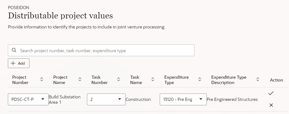

In the first row provided, click the following fields to add a value or combination of values for the rule:
Project Number
Task Number
To add a task, you must first select the project number that the task is associated with.
You must double-click the Task field to see the list of values.
Expenditure Type
The following image shows an example of a row with a project number, task number, and an expenditure type.
