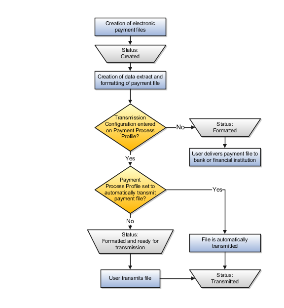

The following figure illustrates the flow of statuses that are associated with the creation of electronic payment files.
         The following table describes how actions performed by Payments or by you change the status of the electronic payment file.
| Action Taken by Payments or By You | Status of the Electronic Payment File |
 | Failed validation and pending action |
 | Retry payment file validation |
 | Created |
 | Terminated |
 | Failed formatting and pending action |
 | Formatted |
 | Formatted and ready for transmission |
| Payments successfully transmitted an electronic payment file to the payment system or financial institution. | Transmitted |
| Payments failed to transmit an electronic payment file to the payment system or financial institution. | Transmission failed |
 | Transmitted |
 | Terminated |
