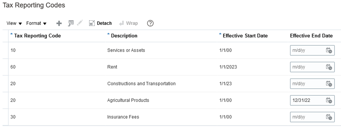

You must update the tax reporting types using the Manage Tax Reporting Types task to
use the new payment category exemptions
Click Navigator, Others, Setup and Maintenance, Search, and Manage Tax
Reporting Types.
Search for the tax reporting type code, ORA_JEIL_SHAAM_CATEGORIES.
Add Tax Reporting Code 20 – Agricultural Products effective 31-Dec-2022.
Add Tax Reporting Code 20 with Constructions and Transportation description effective 01-Jan-2023
Add Tax Reporting Code 60 with Rent description effective 01-Jan-2023.
This image shows the Tax Reporting Codes for the selected tax reporting
type.
Click Save.
