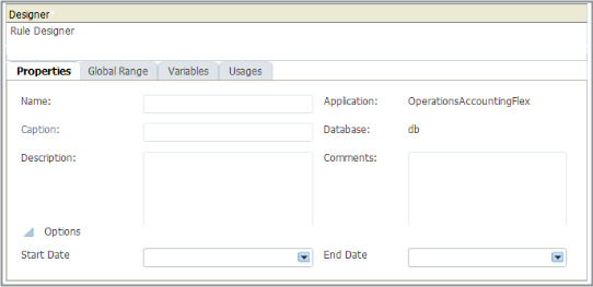

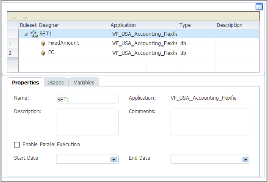

You set up allocation rules and rule sets using Calculation Manager. The date fields are in the Properties tab in the Rule Designer and Rule Set Designer.
Here's a screenshot of the Properties tab on the Rule Designer.
         Here's a screenshot of the Properties tab in the Rule Set Designer.
