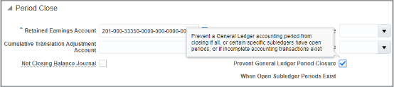

               In the Period Close section, select the Prevent General Ledger Period Closure When Open Subledger Periods Exist option. Here's an image of the ledger option with field help on the Specify Ledger Options page.

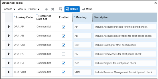

               In the Lookup Type field, enter ORA_GL_INCLD_STRICT_PRD_CLOSE and click Search. Here's an image of the search results with the lookup codes, status, meanings, and descriptions.
               Select the Enabled check box to deselect the subledger that you want to exclude. Note:You can include a previously excluded subledger by selecting the Enabled check box again.
