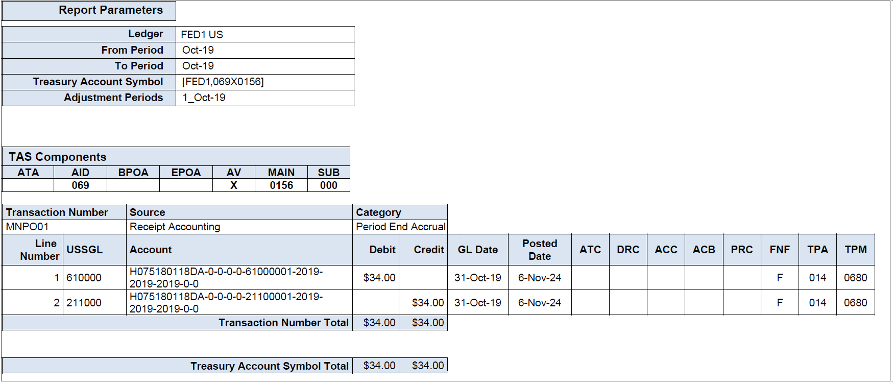

The following image shows the transactions reported on the GTAS Transaction Register Report that's generated using sample data:

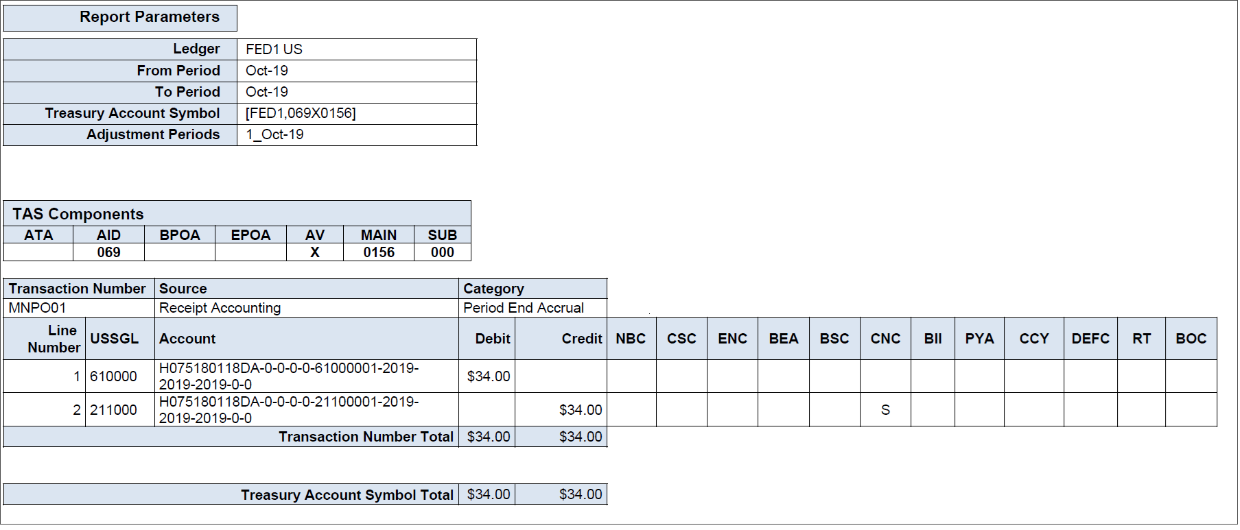

The following image is a continuation of the preceding image and shows the transaction details for the remaining federal attributes on the GTAS Transaction Register Report:
