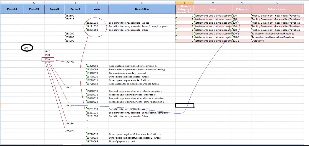

Here is an example that demonstrates how to set up a mixed hierarchy plan.
The existing plan has the value 262510 for a parent account of the postable accounts: 26251010, 26251020 and 26251050. Under the same hierarchy and based on the JPK account categories provided by the Polish tax authorities, these accounts are set as children to the JPK220 JPK Category Account. This is under the JPK2 Group Category account of the JPK hierarchy structure. However, the 262510 Parent account is set under parent2:
  • REP2610, which can be under parent3 REP2T61
  • other parent levels
Here is the image depicting the above example:
Image shows an example of a mixed hierarchy plan.
