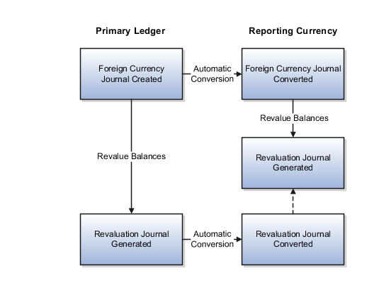

Here's a high-level view of the five journals that are going to be created in the primary ledger and reporting currency.
The first journal is the foreign currency journal entered in the primary ledger. The second journal is the automatic conversion of that journal in the reporting currency. The third journal is the revaluation journal generated in the primary ledger. The fourth journal is the automatic conversion of the revaluation journal in the reporting currency. The fifth journal is the revaluation journal that's generated in the reporting currency.

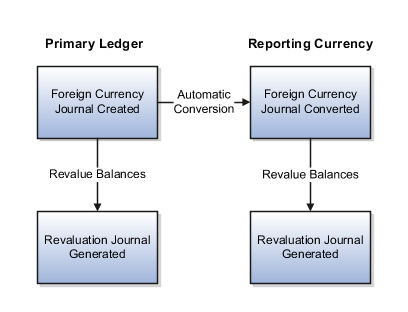

Here's a high-level view of the four journals that are going to be created in the primary ledger and reporting currency.
The first journal is the foreign currency journal entered in the primary ledger. The second journal is the automatic conversion of that journal in the reporting currency. The third journal is the revaluation journal generated in the primary ledger. The fourth journal is the revaluation journal that's generated in the reporting currency.
