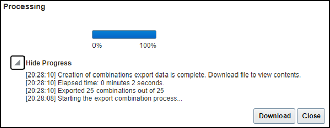

- Click Prepare in Spreadsheet. The Processing dialog box
opens. If you click Show Progress, you can see the number of
combinations being downloaded and the state of the download.
Here’s an example of a Processing dialog that’s 100% complete. The cross-validation combination set has 25 combinations and they’ve all been exported and are ready to download.
- After the process completes, click Download to download the CrossValidationCombinationSet.zip file.
