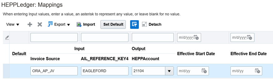

In the mapping set, you map a combination of input values to specific output values. You can use the predefined reference keys for joint ventures as the input source in your mapping set. See Reference Keys for Joint Venture Payables Invoices for more information. For example, you can use Reference key 4 for mapping the joint venture name so that it appears on each invoice line.

The following image shows the Mappings section with values entered for the input and output sources. The two input columns named Invoice Source and AIL_REFERENCE_KEY4 are mapped to the values ORA_AP_JV and EAGLEFORD respectively. The output column named HEPPAccount is mapped to account 21104. This means all payables invoices created for joint venture EAGLEFORD will use natural account 21104 for the liability account.
This image shows an example of input and output mappings in a mapping set that's used to define a liability account for joint venture payables invoices.
