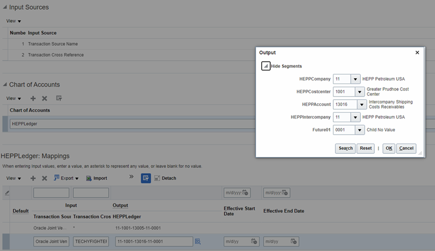

In the mapping set, use the Transaction Cross Reference field on the invoice as the input source. This field records the joint venture name in the invoice header. You can then map the joint ventures to their respective receivable accounts.
The following example shows a mapping set to define a receivable account. In the mapping set, the input sources are Transaction Source Name and Transaction Cross Reference. The chart of accounts is HEPPLedger. Values have been identified for the input sources and the output source, with the Output dialog box displayed to show the segments that make up the account:
This image shows the Output dialog box for selecting each segment that makes up a receivable account.
