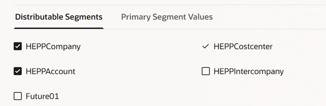

    The following image shows an example of other segments named HEPPCompany and HEPPAccount that are selected in addition to the primary segment on the Distributable Segments tab.
    This image shows the Distributable Segments tab with the selected segments.
