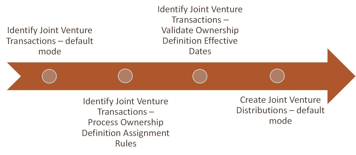

You can set up the preceding processes to run on a schedule, or you can run them on demand as needed. You use the Joint Venture Transactions and Joint Venture Distributions work areas to manage your exceptions from these processes. See Correcting Issues with Joint Venture Transactions and Distributions for more information.
The following image shows the flow of running these processes:
After you run the processes to identify and distribute joint venture transactions, you can run the processes to draw from partner contributions to cover distribution amounts, create invoices or journal entries from joint venture distributions, send cost adjustments to Project Costing, and so forth.
