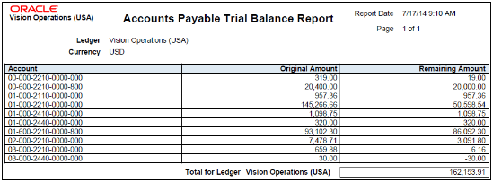

The Payables Trial Balance Report lists and subtotals, by supplier and liability account, all unpaid and partially paid invoices that Oracle Fusion Payables transferred to the general ledger.
The following figure is an example of the report.
Key Insights
The report identifies the accounts payable balance at period end and provides the invoice details that comprise that balance.
