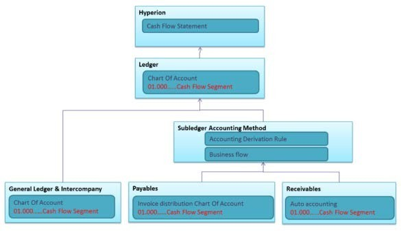

Accounting Rules
The basic rule of the cash flow collection is getting the cash flow segment amount from the opposite side of the cash account. By using this way we get the amount from each cash transaction entry. And then summarize them to each cash flow rows of the cash flow statement in Hyperion Financial Report.
This image displays the flow diagram for Accounting Rules:
This image displays the flow diagram for Accounting Rules.

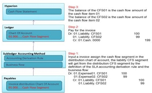

In Payables, you can get the cash flow item and amount from each payment. The source of the cash flow item will be derived from each invoice distribution line cash flow segment.
This image displays the flow diagram for Payables:
This image displays the flow diagram for Payables.
According to the rule above, apply the source default rule when you input the invoice or define the account source for cash flow segment:

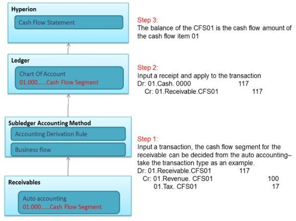

In Receivables, you can get the cash flow item and amount from each receipt and apply application. The source of the cash flow item will be derived from each transaction receivable account cash flow segment.
This image displays the flow diagram for Receivables:
This image displays the flow diagram for Receivables.
According to the rule above, apply the source default rule when you input the transaction or define the account source for cash flow segments:

Oracle General Ledger
You must input the Cash flow segment in the chart of account in the opposite side of the cash line in the cash related journal lines. The cash line should be the default value: 0000 no cash.
