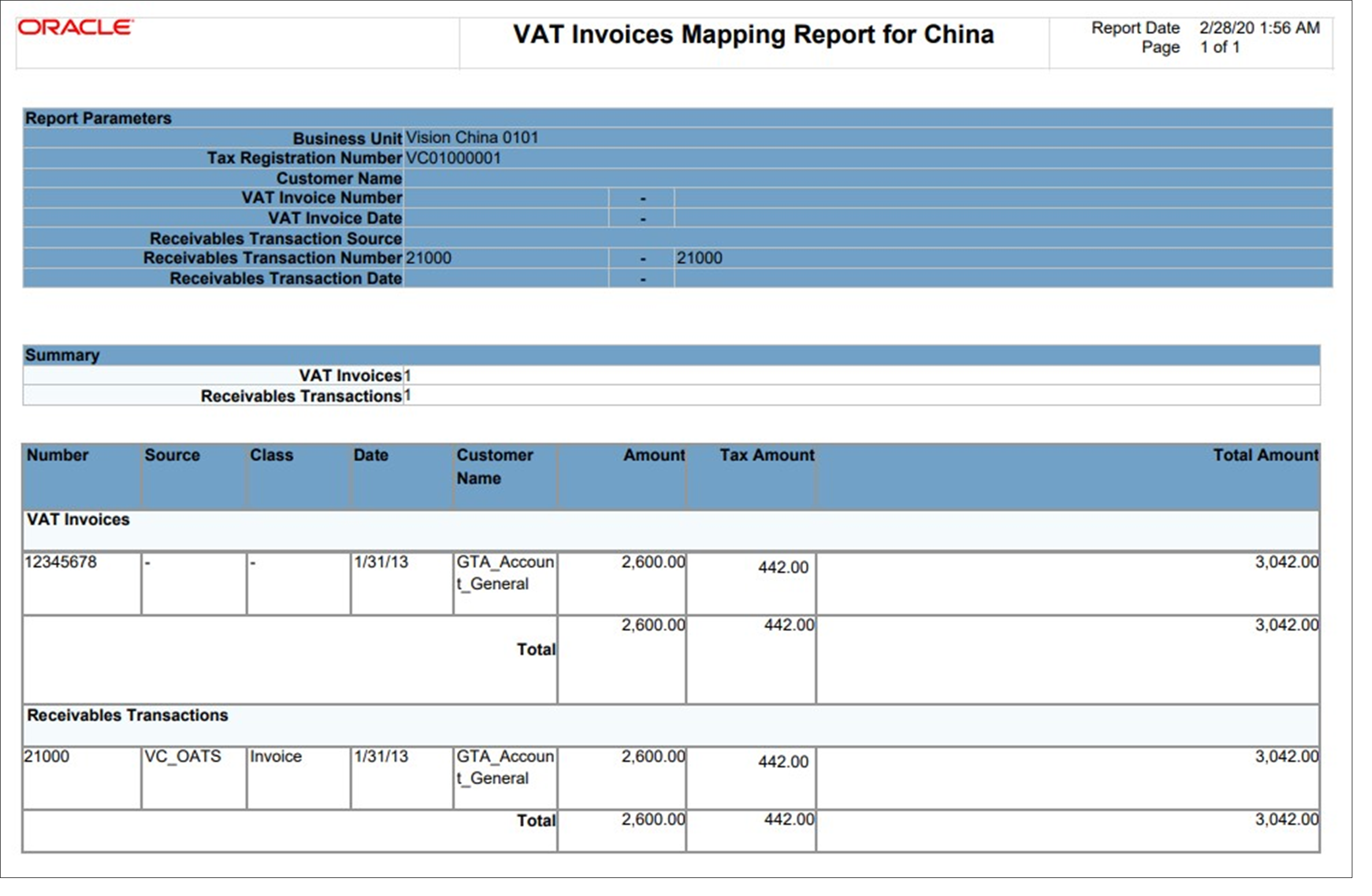

This image shows the Golden Tax Discrepancy Report for China report.
The report displays the discrepancies within different sections for each receivables invoice:
  • Header: In this section, the discrepancies in the header attributes, such as VAT Invoice Type, Address, Bank Name, Bank Account Number, and Amounts, appear.
  • Lines: In this section, discrepancies in the line attributes, such as Item Description and Model, appear.
  • Missing AR lines: In this section, AR lines that are present in receivables but not in the Adaptor, or vice versa, appear. This discrepancy arises when a new line is added, or an existing line is deleted from a receivables invoice after it is transferred to the Adaptor.
  • Unmatched lines: When the VAT invoice lines do not match the lines of the corresponding invoices in the Golden Tax Adaptor, then both lines appear separately.
