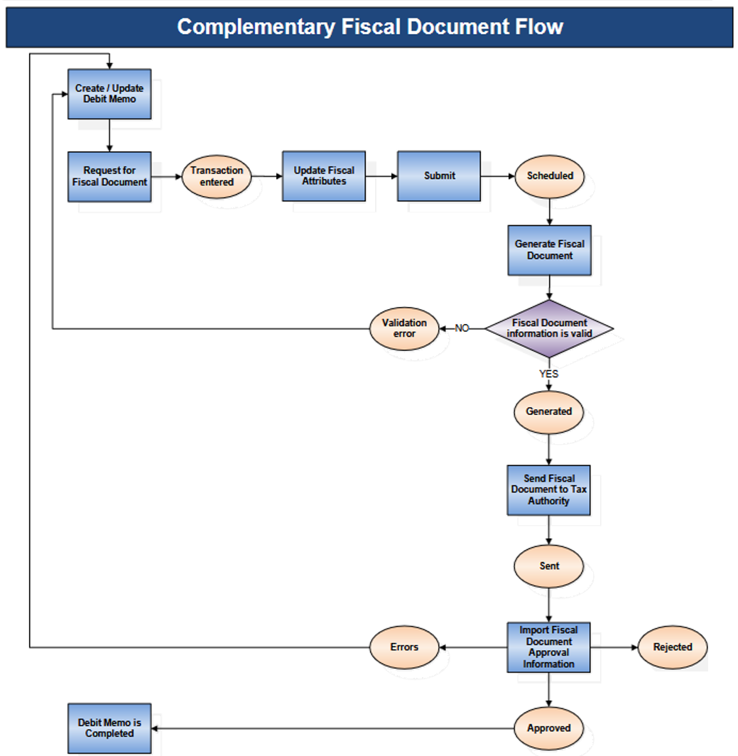

This image illustrates the complimentary fiscal document flow:This image shows the complimentary fiscal document flow.
