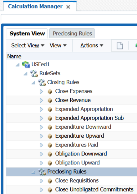

    Here's an example of how the RuleSets node looks like:
    This image shows an example of the rule set for year-end close rules.
