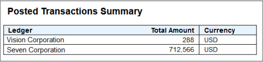

Posted Transactions Summary
This section shows a summary of the posted balances by ledger. Only the default user or role receives this summary. If no accounting transactions were successfully posted for any ledger after an accounting automation run, a message appears in place of this section.
Here's an example of a posting summary. A total of 288 US dollars was posted to the Vision Corporation ledger and 712, 566 US dollars was posted to the Seven Corporation ledger.
This figure shows an example of the Posted Transactions Summary section in an email notification. This summary has a table with three columns: Ledger, Total Amount, and Currency. The table has two rows of data.
Here's more information about each column shown in the example.
Column
Description
Ledger
Names of the ledgers (primary, secondary, and reporting currency) that journal batches were posted to.
Total Amount
Sum of the accounted debits for the journal batches that were posted to the ledger.
Currency
Ledger currency.

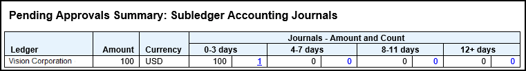

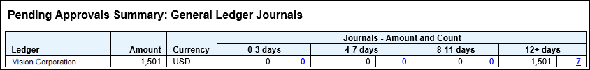

Pending Approvals Summary
There are 2 sections that summarize pending approvals:
  • Pending Approvals Summary: General Ledger Journals
  • Pending Approvals Summary: Subledger Accounting Journals
These sections show a summary of the General Ledger and Subledger Accounting journal batches, by aging bucket, that require approval, are in the process of being approved, or that were rejected. The default user and the users (or roles) assigned the Approval error category, receive this summary.
Here's an example of the General Ledger Journals summary. The Vision Corporation ledger has 7 General Ledger journal batches totaling 1,501 US dollars that have been pending approval for more than 12 days.
This figure shows an example of the Pending Approvals Summary: General Ledger Journals section of an email notification sent after an accounting automation run. The section has a table with a column for the ledger, amount, and currency, followed by aging bucket columns, each with an amount and count. The table has one row of sample data.
Here's an example of the Subledger Accounting Journals summary. The Vision Corporation ledger has 1 Subledger Accounting journal batch totaling 100 US dollars that’s been pending approval from 0 to 3 days.
This figure shows an example of the Pending Approvals Summary: Subledger Accounting Journals section of an email notification sent after an accounting automation run. The section has a table with a column for the ledger, amount, and currency, followed by aging bucket columns, each with an amount and count. The table has one row of sample data.
Column
Description
Ledger
Ledger (primary, secondary, or reporting currency) of the journal batch.
Amount
Sum of the journal batches that are in the approval flow.
Currency
Ledger currency.
Journals Amount
Total amount of journal batches pending approval broken down into the following aging buckets since the last approval action: 0 - 3 days, 4 - 7 days, 8 - 11 days, more than 12 days.
Journals Count
Number of journal batches pending approval broken down into the following aging buckets since the last approval action: 0 - 3 days, 4 - 7 days, 8 - 11 days, more than 12 days. Links to the Pending Approvals Details section of the email notification.

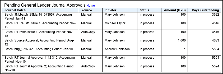

There are 2 sections that provide details on pending approvals:
  • Pending General Ledger Journal Approvals
  • Pending Subledger Accounting Journal Approvals
These sections provide the details for the Pending Approvals Summary sections.
Here's an example of the General Ledger journal batches in the process of being approved. Various users initiated the approvals and the batches have been pending approval for many days.
This figure shows the details for the seven General Ledger Journal batches that are pending approval. The table has six columns: Journal Batch, Source, Initiator, Status, Amount, and Days Outstanding.
Here's an example of the Subledger Accounting Journal batch that’s in the process of being approved.
This figure shows the details for the Subledger Accounting Journal batch that's pending approval. The table has six columns: Journal Batch, Source, Initiator, Status, Amount, and Days Outstanding.
Column
Description
Journal Batch or Subledger Journal
Name of the journal batch.
Source
Source of the journal batch.
Initiator
User who requested the approval.
Status
Approval status of the batch.
Amount (Currency)
Journal batch amount in the ledger currency.
Days Outstanding
Number of days since the last approval action.
