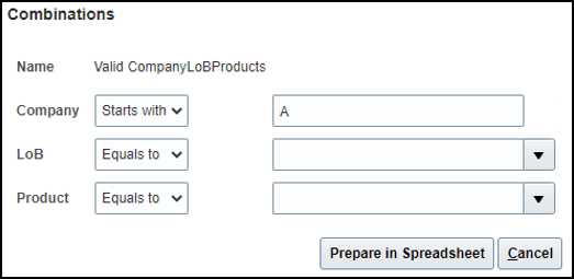

- On the Combinations dialog box, filter on company values that start with the letter
A.
Here’s an example of the Combinations dialog box.
- Click Prepare in Spreadsheet and after the process completes, click Download.
