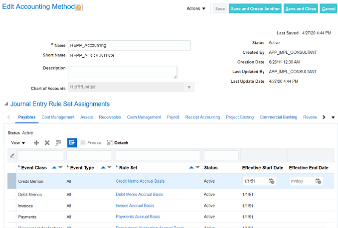

    The following example shows an accounting method for a chart of accounts named HEPPLedger. The Payables subledger contains a rule set for each event class: Credit Memos, Debit Memos, Invoices, Payments, and so forth. The rule set establishes the data required for a journal entry line for an event class.
    This image shows the Edit Accounting Method section with an accounting method name HEPP_Accounting in the Name field and other details related to the accounting method such as the short name, description, chart of accounts, and so forth. The focus of the image is to show the section below the accounting method, Journal Entry Rule Set Assignments. This section has multiple tabs: Payables which is selected, Cost Management, Assets, Receivables, Cash Management, Payroll, Receipt Accounting, Project Costing, Commercial Banking, Revenue. The table in this section has the following columns: Event Class, Event Type, Rule Set, Status, Effective Start Date, Effective End Date. The focus of this table is to show the first row that is highlighted, which contains the following data respective of the aforementioned columns: Credit Memos, All, Credit Memo Accrual Basis, Active, 1/1/51, m/d/yy.
  5. In the event class row, click the rule set to edit it.
